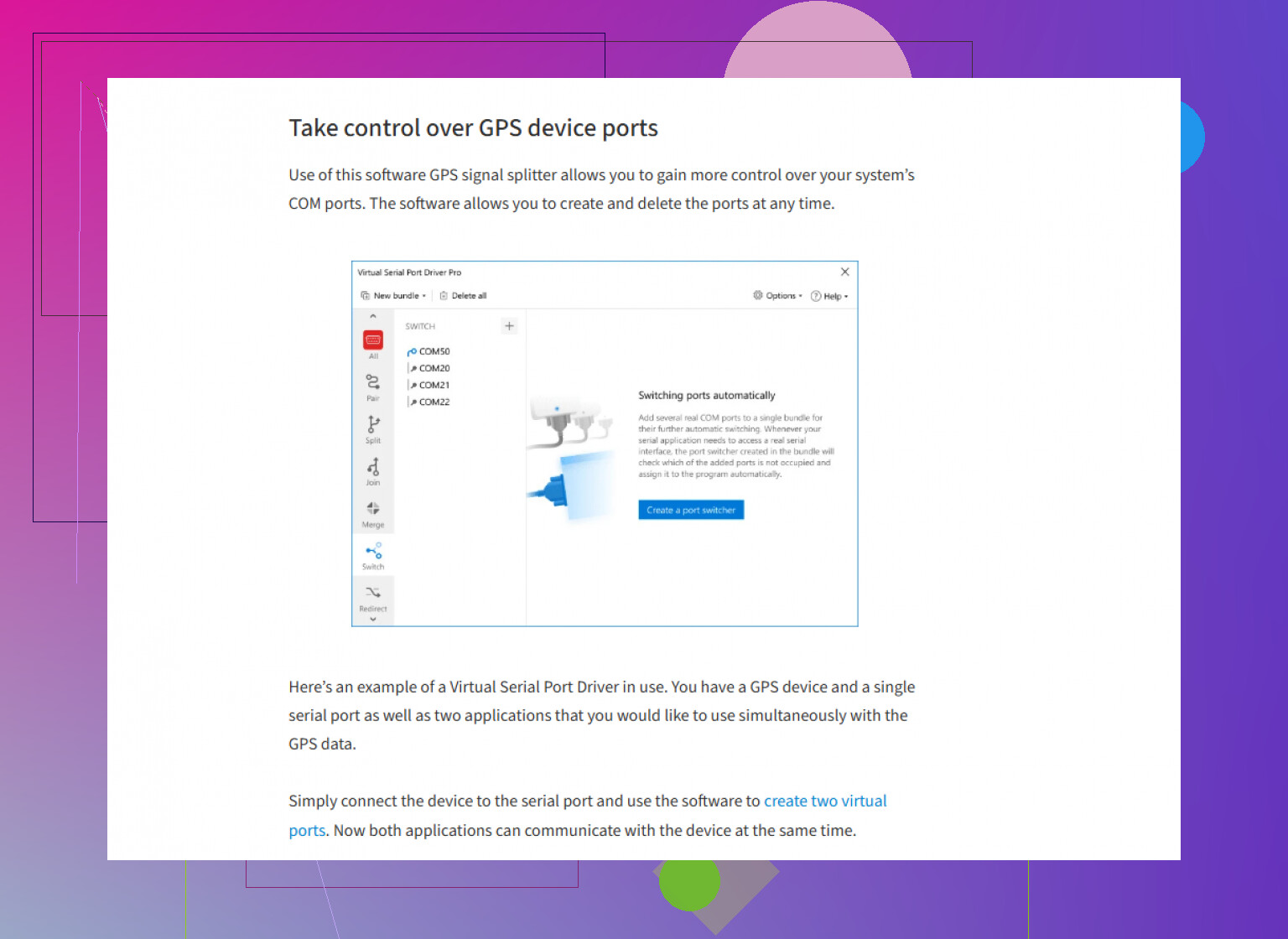

Short answer: You’ve got one serial port and two devices that both want to be plugged in? For actual hardware-to-hardware comms, that’s about as friendly as two cats in a cardboard box. The previous posts hit the common options, but let’s break it down like a true troubleshooting session:
1. Software Solutions: Virtual Serial Port Driver is top-tier for letting multiple apps talk to one physical device or for creating virtual port pairs (think mirroring data). Awesome pro: no hardware needed, fast to deploy, great for development, monitoring, or logging. Con: it can’t morph one physical port into two for two hardware endpoints. If you try to plug two devices into one port via splitter software, you’ll only get tears—works for apps, not devices. The main rivals are serial-splitter and generic virtual port creators; most play in the same league for virtual use.
