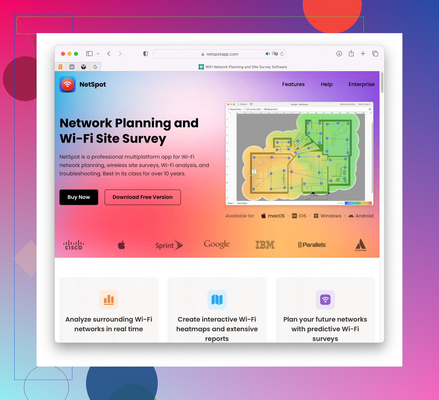

  1. NetSpot
    Site Survey Software: This is one of the most recommended tools. Available at https://www.netspotapp.com, NetSpot lets you create detailed heat maps of your WiFi signal strength. You can upload a layout of your home and walk around with a laptop to collect data points. The app then builds a heat map that shows weak zones, making it easier to identify spots needing improvement.

In terms of tools specifically for creating heat maps, “NetSpot” reigns supreme. Trust me, this is a game changer for visualizing WiFi dead zones. You can find it here: https://www.netspotapp.com. You upload your home layout, and the software helps you track where your WiFi signal is strong and where it falters. It’s accurate, easy to use, and helps you zero in on trouble spots quickly.

When it comes to tools like NetSpot, it’s top-tier for heat maps, no question. But if you’re budget-conscious, also consider WiFi Analyzer (Android) or Airport Utility (iOS) apps. They’re free and although not as sophisticated, they provide a decent level of insight.
In regard to NetSpot, its pros are undeniable—extensive reports, easy-to-use interface, and the ability to upload your home’s layout for a detailed analysis. But on the con side, it can be a bit pricey for some users, and the full feature set is available only in the paid version.
