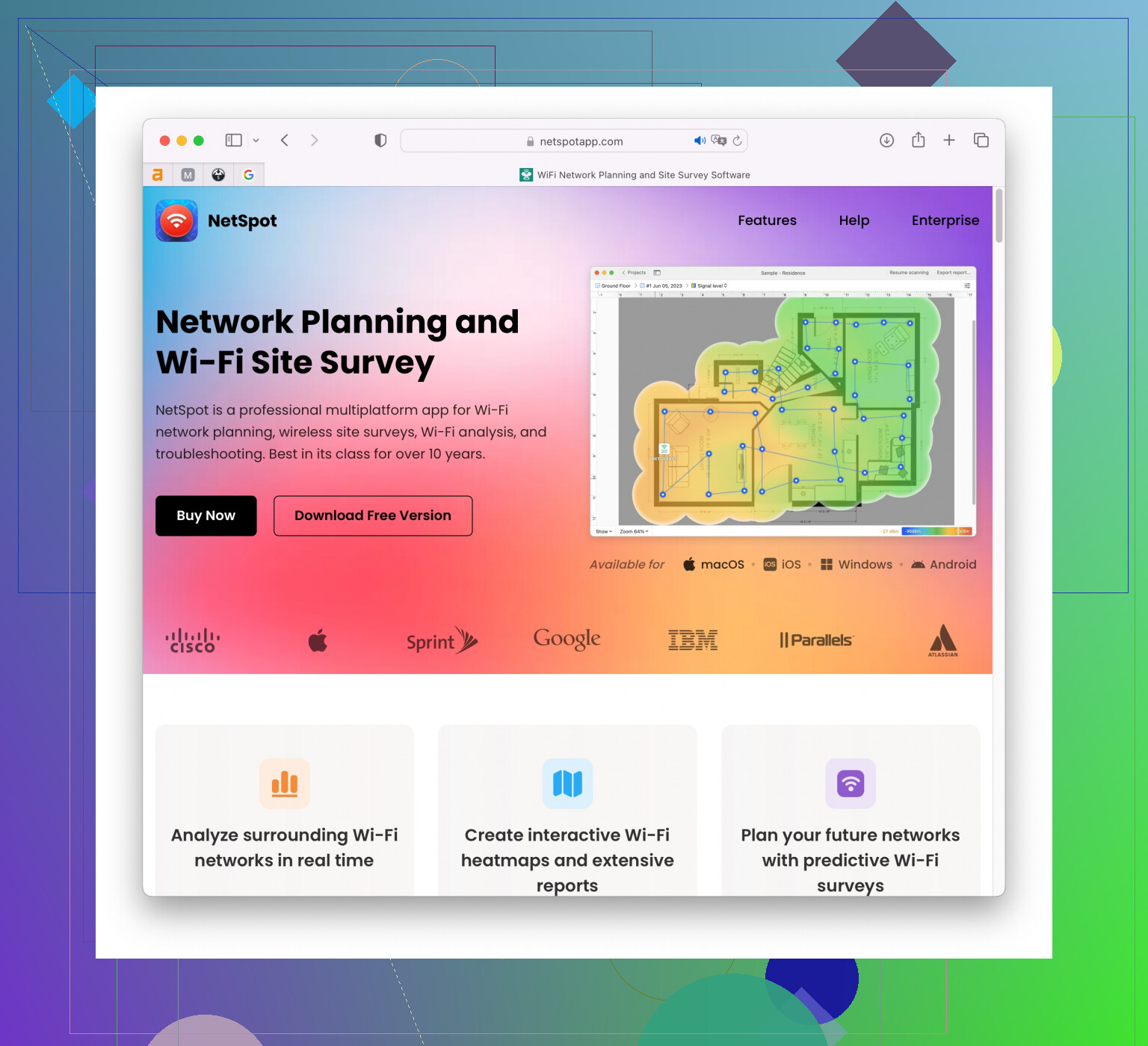

  1. Wi-Fi Survey Software: This is the bread and butter of an RF site survey. NetSpot
    is one of the top contenders for this job, and it’s pretty user-friendly. It allows you to map out the signal strengths, coverage, and identify any interference areas. NetSpot has a good blend of features and usability, but keep in mind it’s a paid software. Competitors like Ekahau and Acrylic Wi-Fi Professional offer similar functionalities but might come with steeper learning curves or price tags.

  • NetSpot Pros: User-friendly interface, robust reporting, and Mac/Windows support make it quite accessible. The visual heat maps are particularly helpful.
  • NetSpot Cons: Limited functionality in the free tier (compared to paid options), and the cost might be a hurdle for smaller businesses.

  • Documentation: Use tools like NetSpot which offer comprehensive documentation features. Keep everything recorded because, trust me, you’ll need it when troubleshooting later. Don’t just rely on a tool’s internal storage; create redundancy through physical notes or separate digital logs.
You can access detailed features and download it from NetSpot if you haven’t already. Toss in Ekahau or iBwave for predictive modeling and you’ll cover both immediate and future-proofing needs.
