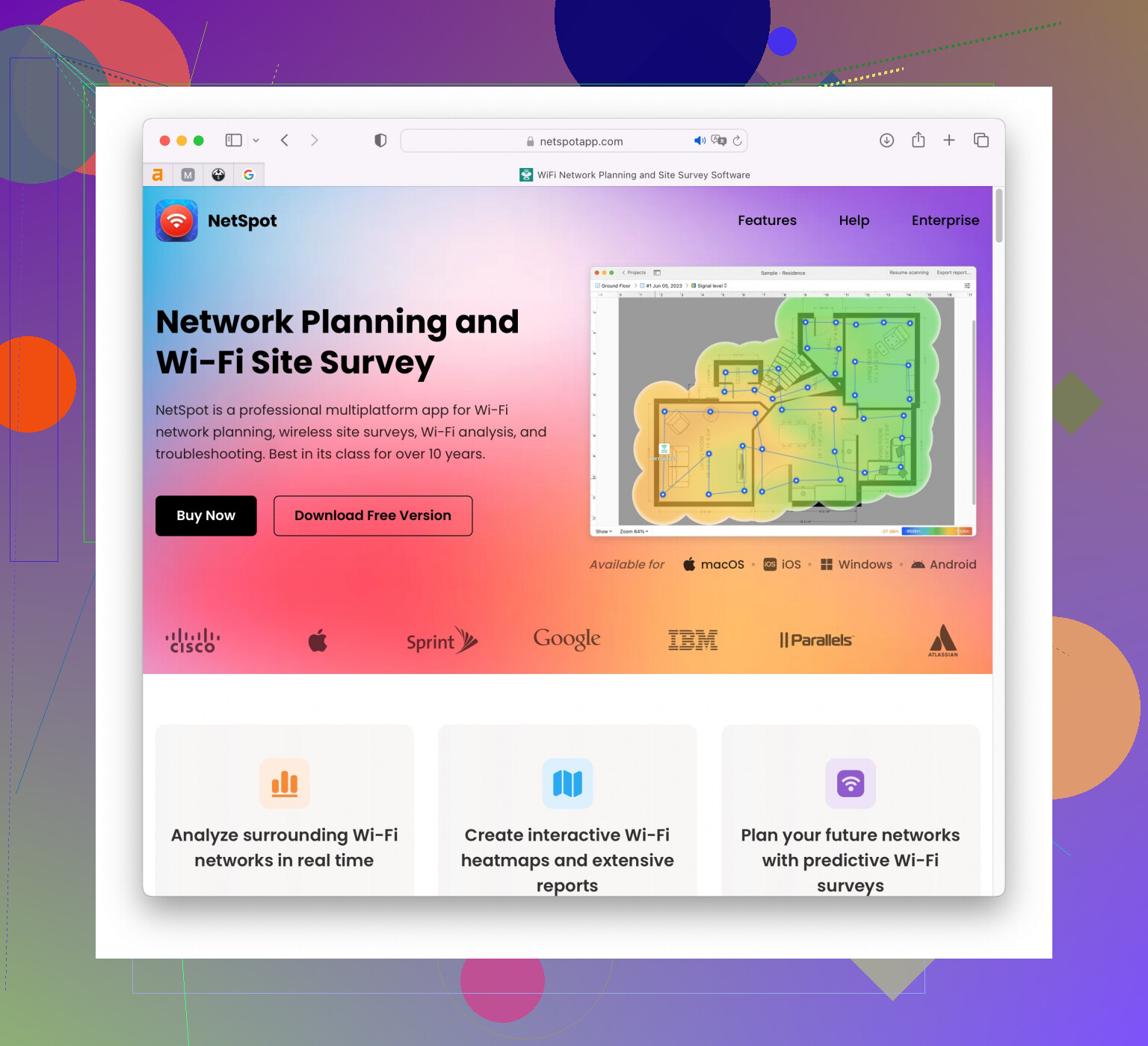

  4. Change Channel or Frequency Band: If your neighbors are all using the same WiFi channel, interference could be the issue. You can log into your router settings and switch to a less crowded channel. Tools like NetSpot
    Site Survey Software can help you identify the best channel to use. It provides detailed insights on how your network is performing and where the signal is weak. Pros include its detailed maps and ease of use. On the downside, it might be overkill for a simple home setup and isn’t free.

Lastly, a detailed scan with WiFi analyzer tools like NetSpot can really be enlightening. It gives you the lay of the land in terms of local radio frequencies and can suggest alternative channels to switch to — but take that as just a starting point. You still need to test those adjustments since the router’s position and environment could affect the signal quality.
For the curious, head over to ‘https://www.netspotapp.com’ and check out NetSpot Site Survey Software. It’s quite insightful in mapping your network’s weaknesses and strengths, even if it feels a bit overkill for simpler setups.

Mind the Neighbors: If close proximity housing means everyone’s using WiFi, things could get convoluted. It’s worth having a WiFi analyzer tool check how crowded the channels are around you. Tools like NetSpot Site Survey Software—available at 'https://www.netspotapp.com’—are pretty handy in pinpointing exactly where the coverage drops and helping you pick less crowded channels.
