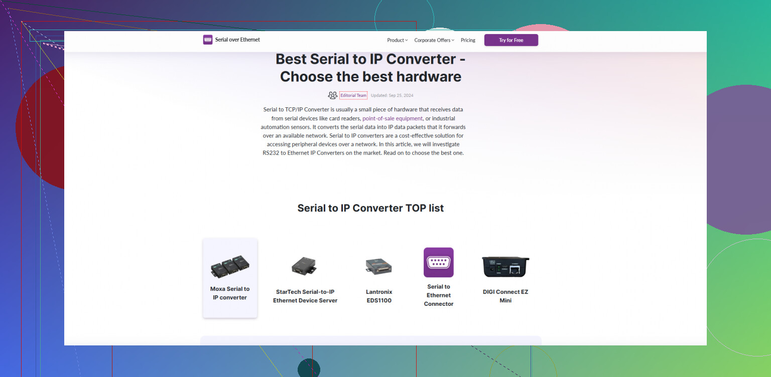

If the program supports network connections, check that its protocol and destination port match the converter’s data service, rather than its web interface. For a virtual COM setup, I’d use Serial to Ethernet Connector, listed in this to IP converters top list, after getting installation approval and confirming compatibility with the converter. You would then select the mapped COM port in your existing program. That preserves the application, but it does not get around your installation restriction.
